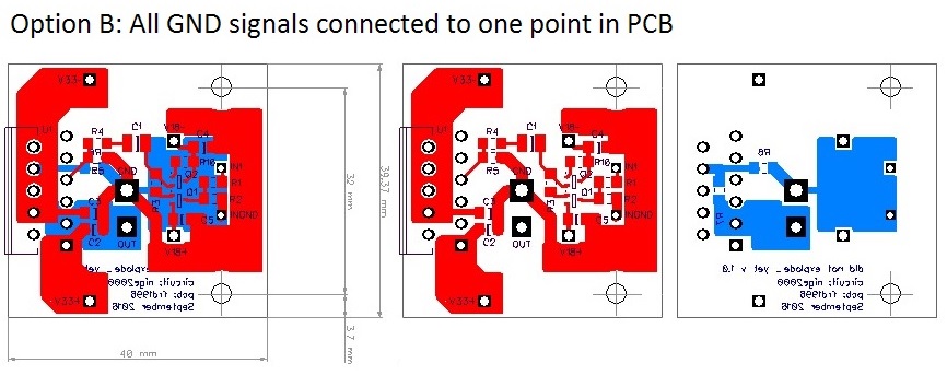

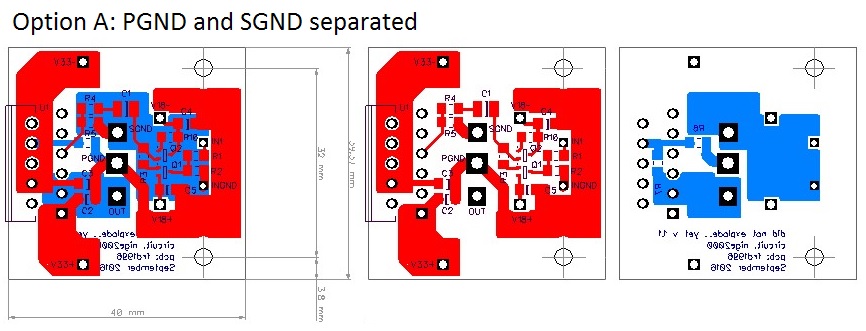

frd1996
Posts: 173
Post by frd1996 »
My second attempt with PCB. Two options implemented.
nige2000
Posts: 4253
Location: meath
Post by nige2000 »
both look great
option a will allow for both option with a bridge wire between sgnd and pgnd
bet there'd be fun double blind testing these options :)
Posts: 4166
Great work Fredyrk and all.....
jkeny
Posts: 2387
Post by jkeny »
Yea great work, Fredyrk
I think Nige's idea of having a wire strap to change from A to B config is a good one - always good to have options!
Hard to say if there will be any audible difference between A & B - it depends on how the two channels are connected & if there is any ground noise voltages on the upstream source connected to the amp channels.
