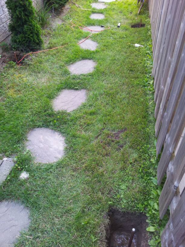

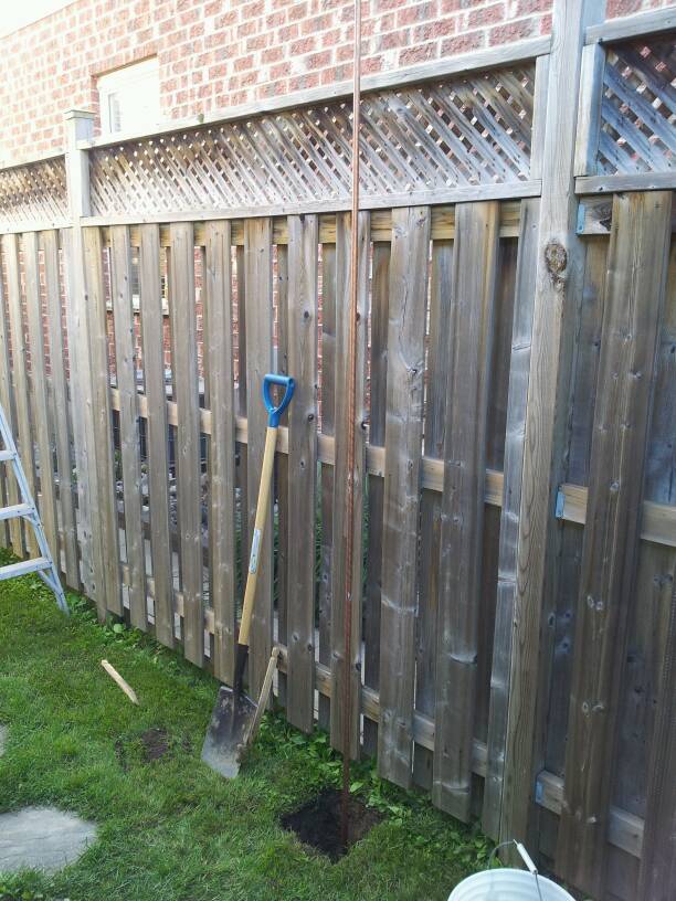

Here was the work on the other side of the wall:

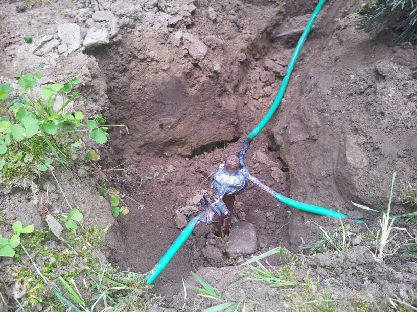

The the wire was soldered to the copper rods.

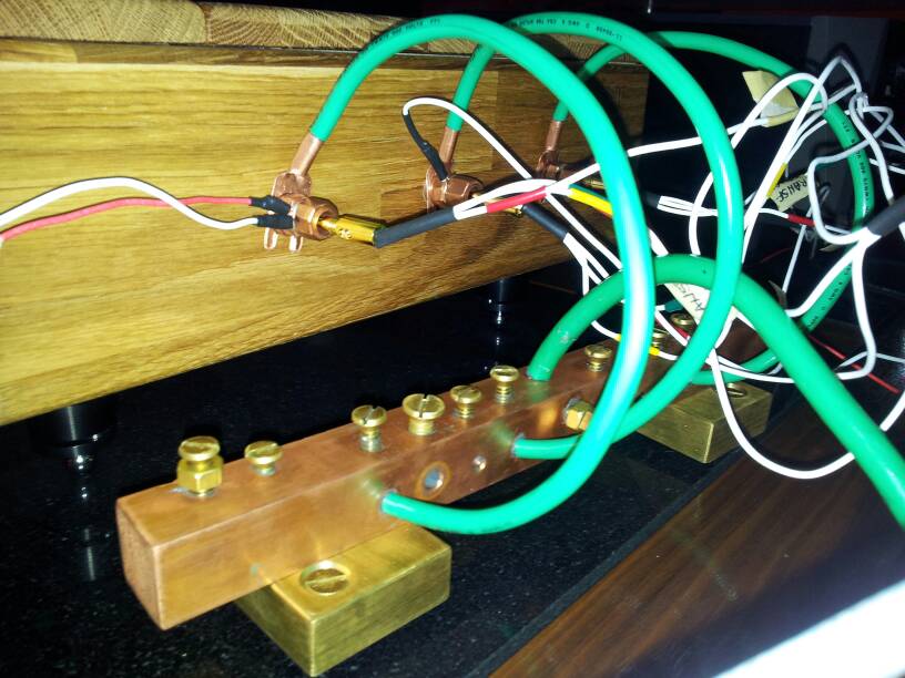

tony wrote:Love the good advice Adam re timing on installation.Great photo's. Will have to give something like that a go at some point. That is silver plated wire going to the outside ground?
The wire is gauge #1(8mm) copper wire (NOT silver plated).......ONE PIECE, connecting all the 3 posts in triangle and the cooper bar on the other side .
I don't know if this is the best way to do (if there is a such thing), but it works in my case. Not in the way I expected (to be better than Tellus), but it gives a big improvement with Tellus.

The outside ground wire is just copper. Cooper bar is 12"x1"x1", the outside posts are 10 feet long and 3/4" tick.
The wire used from the chassis to Tellus makes BIG difference.
First I had 16 gauge silver coated stranded wire in Teflon jacket, then I changed to 16 gauge pure silver solid wire in Teflon jacket, the difference was very noticeable. I have one Entreq Eartha Silver cable same 16 gauge, but it sounds way better that my pure silver wire!!! No idea why.....maybe because of the extra cotton jacket on top of teflon?! Any thoughts?
