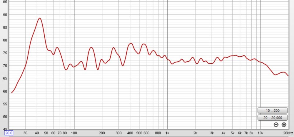

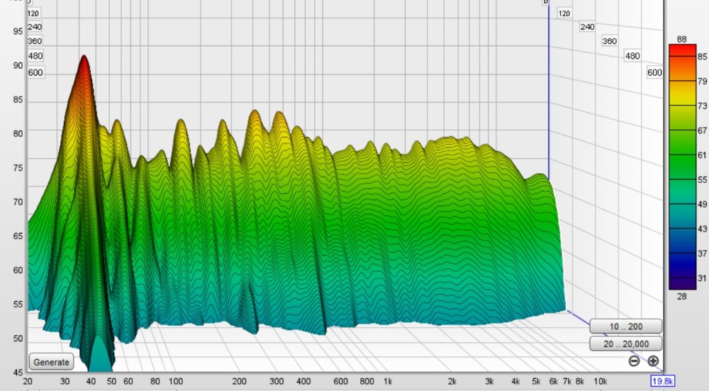

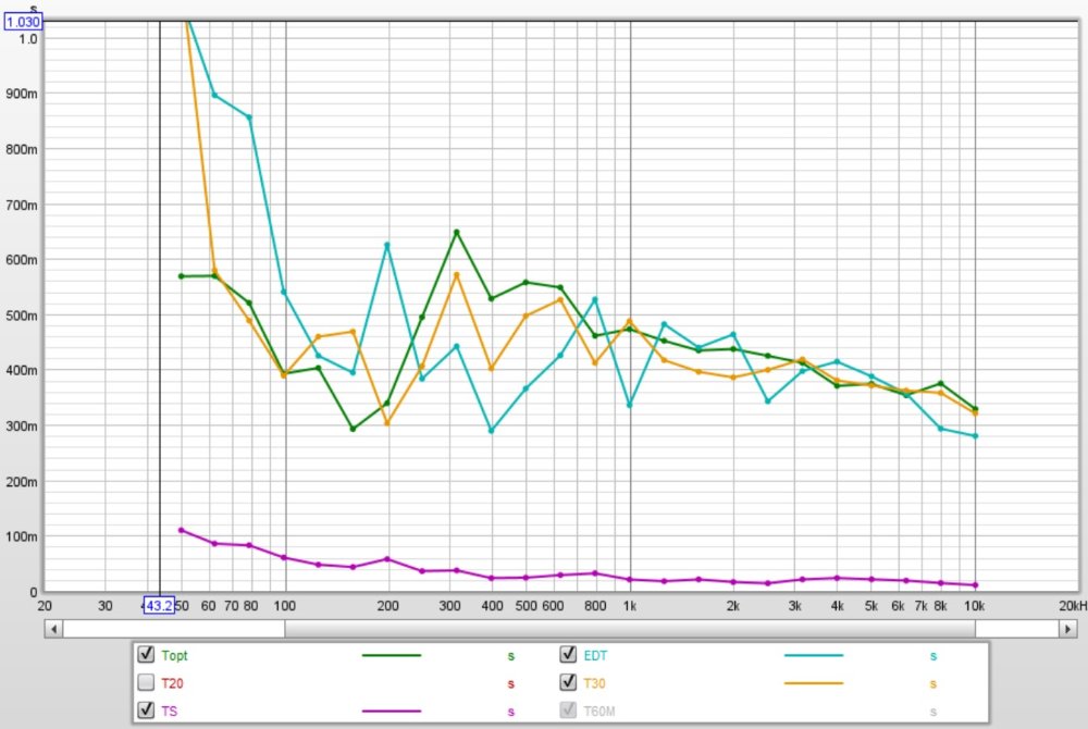

Some initial measurements. No room treatment, just sofa, hifi shelf, rug.
Frequency response actually looks quite good, better than i expected! Thought those speakers are really rolled off, but actually they're not, it was the old room that was very mids heavy. There's peak +15db at 42hz which is a room mode (room is 5.2x4.1m, 42 hz is 8.1m, so its that 4.1m length thats resonating), but solved it temporarely with narrow EQ in Roon, works nicely, until i find a better solution (tuned bass trap/absorber?).
Room feels echoy, but per RT60 average decay is aroubd 600ms, which should be ok for normal listening living rooms (not studios), except that long ringing at 42hz of course. So not sure if i am reading rt60 wrong? Same decay numbers are also in the waterfall.

I tried moving mic around (took 6 measurements around listening position) but bass response didn't change that much. Didn't try to measure different speaker positions, but i can hear that room mode if i move it a bit forward or backward. Since speakers are now against the longer wall, i suspect that rotating the whole room 90 degrees would have meaningful impact on room modes, but thats unfortunately not possible (TV position...). Will experiment some more and report back here when i get new graphs...

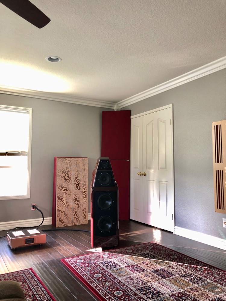

I too had good results with GIK also. A mix of corner traps, absorption and diffusion. You can actually make a lot of this yourself if you are anyway handy. I did this when I found I needed more than I had bought. Absorption is super easy but there are also lots of designs for diffusers online, though they can be time consuming.
I made the panel in the back (2 of them) and 4 additional corner traps to augment what I bought from GIK

Can you go through the process? As in how did you know what you needed and why did you need more than you thought? Positioning etc.?HiFiFan wrote: ↑Wed Feb 07, 2024 1:53 pm I too had good results with GIK also. A mix of corner traps, absorption and diffusion. You can actually make a lot of this yourself if you are anyway handy. I did this when I found I needed more than I had bought. Absorption is super easy but there are also lots of designs for diffusers online, though they can be time consuming.

It was quite some time ago when I did this. I started with some general advise from GIK which I partially adopted. I had also found various online advise from Cardas and others. The room was 21 x 22 feet so almost square. I looked at the biggest issues flutter echo and bass boom. I started with the corner treatment, found an improved either using a single corner trap per corner or 2 (floor to ceiling) on 2 corners. I can’t remember which. With that I later decided to go floor to ceiling on all 4 corners.
Then it was mainly treating the first and second reflection points. Easily found using a mirror and walking the walls. It was really just trial and error after then swapping reflection/light diffusers vs full absorption for the 2nd and back reflection points until I was happy.
I had 3 rugs - felt these were important too.
Sorry can’t remember much more.
I’ll probably have to do this all again now with the new house.
