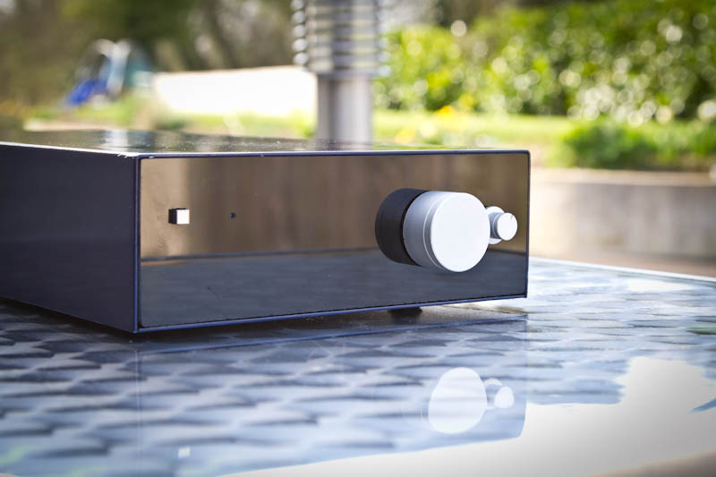

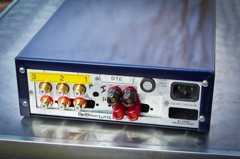

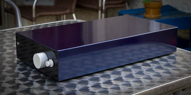

Final pics....
Not much has changed in the internals from the last pics, but I used a stepped DACT type attenuator instead of the Alps blue velvet shown in the earlier pics. I added bigger capacitors in the power supply as well, and lastly, I changed the resistors that set the overall gain of the amp to LDRs. These last ones are worth a mention. They are light dependant resistors - in other words, resistors whose resistance changes depending on the amount of light to fall on them. The particular ones I have used (and the ones that are used by all in audio around the world) are from a company called Silonex, and are actually a package of the resistor, plus an LED. So the idea is that the amount of power you put through the LED creates a certain amount of brightness, and therefore a certain resistance. If you can do that accurately, then the resistance is dead on accurate. Anyway, it turns out that these resistors seem to have a kind of magical sound quality. Example: I had used audiophile kiwame resistors in this position. Well regarded ones.... but when I added in the LDRs I got a better, more defined, cleaner presentation.
Anyway, I think she's kinda finished now. I might go back sometime and do another one with 2 chips per channel paralleled which is meant to give a higher power output, but its not something I feel the need to go for right away.
Excuse the fingerprints on the fascia: I thought I had them all off!
