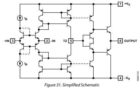

It tried it (and no, its not a folded cascode) and the PSRR was really poor. So I don't think that circuit can be rescued. I am building up a two MOSFET gain stage with both MOSFETs acting as buffers (source followers) and the voltage gain coming from a current mirror in a similar way to how the AD844 gets its voltage gain (bipolar transistors though as they match better). In fact the circuit looks rather like an AD844 cut in half left to right and the bottom half, instead of being a mirror image of the top, is replaced with current sources. The CCSs give excellent PSRR which is the reason for using them.
Skipping through the AD844's datasheet the one thing very conspicuous by its absence is the customary PSRR plot vs frequency. I wonder if the omission is by design due to it looking like a dog's dinner? On DIYA sometimes heated debates arise between devotees of CFB amps and the more traditional VFB (LTP input, popularized by Doug Self) and even the proponents of CFB admit that their amps suck in PSRR.
